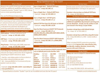

A colleague posted this on another feed.
This is excellent information for anyone considering using NMAP to scan their OT/ICS environment.
He also provides great advice as follows:
Before you just starting scanning away in your OT environment though, consider the following:
1. Any active scanning tool, such as Nmap, has the potential to impact system responsiveness and availability. Many OT assets, especially older ones, can have interoperability issues when scanned by Nmap resulting in the asset failing, reloading or even completely crashing and needing to be replaced.
2. If risk to physical safety, environmental safety or production are ever at question for your environment, do not use Nmap in your OT network.
3. Active scanning should never be used inside production facility networks against Level 0 to 2 assets.
4. Consider using Nmap for scanning of "traditional IT systems" that are in use within the OT network such as data historians, engineering workstations and domain controllers running Windows or Linux. Such testing should be coordinated in testing windows. Conducting Nmap on a regular basis against these very popular targets for attackers could help discover if a malicious service has been installed on these assets without your knowledge. Only scan these resources when a secondary system can be made immediately available to eliminate any risk to impacting production.
5. Reserve Nmap scanning for all other OT assets for any backup facilities or testing during Factory Acceptance Testing (FAT)/Site Acceptance Testing (SAT).
6. Be sure to scan your external Internet-facing ranges to ensure you do not have any assets directly exposed to the Internet.
Bottom line: BE CAREFUL
