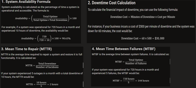

SA3
Does this help?
MTD (Maximum Tolerable Downtime) is the sum of RTO (Recovery Time Objective for hardware) and WRT (Work Recovery Time to fully configure the system and software).
Mean Time Between Failure (MTBF) is the average time until a component fails.
Mean Time to Repair (MTTR) is the average time it takes to repair a failed system.
For example, if MTD is 4 hours and MTTR is 3 hours.
